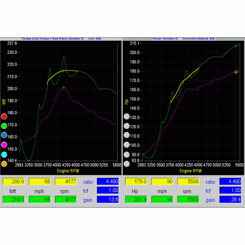

We can tune these 1.5T to produce over 200 HP when Flash Pro is released.

KTuner just released their tuning package........
I'll stick with flash Pro.
